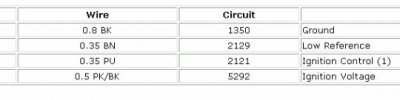

Is there a method to test the cable? I am an electronics technician by trade, just don't have the pin out if the cable. Nor do I know what the voltage should be when that cylinder fires. Thanks for all the help thus far!
24
You should be able to compare the input of the other 3 as a reference against the bad one.
Here's the connector info.

I pulled off the plug for the #2 cylinder and took readings on those pins and then took readings on the plug for #1 cylinder and they were virtually identical. It doesnt seem to me like its an electrical problem...
