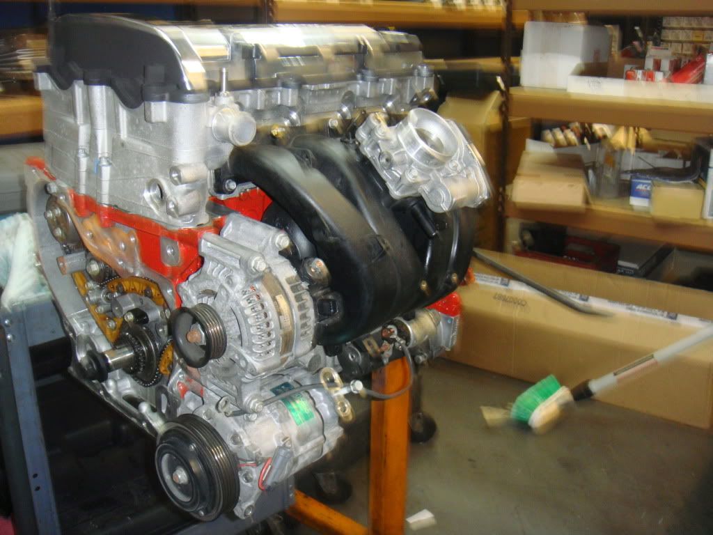

my engine is built already...i got all the parts you have...wiseco 8.9:1 pistons eagle h rods...balance shaft delete for safer higher revs. the head is fully built with .5mm bigger valves and dual coil springs...supertech...
