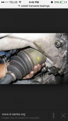

Where this guys hand is, if I grab it there I can move it in and out not significantly but a good deal when we're talking play in terms of bearings and what not. I don't know if there is normally a small amount of play there or not.

There's a normal amount of in and out play between the axle and transmission. Up and down movement would be worrisome.
