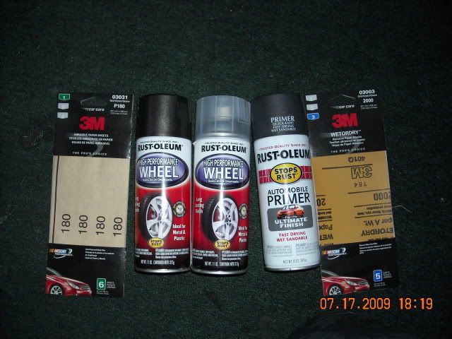

Okay, first off head down to your local autoparts store and pickup the following...
RustOleum High Performance Wheel paint x2
RustOleum High performance Clear Coat x2
RustOleum Auto Finish Primer x3
3M 180 Grit Sandpaper
3M 2000 Grit WetSandpaper..

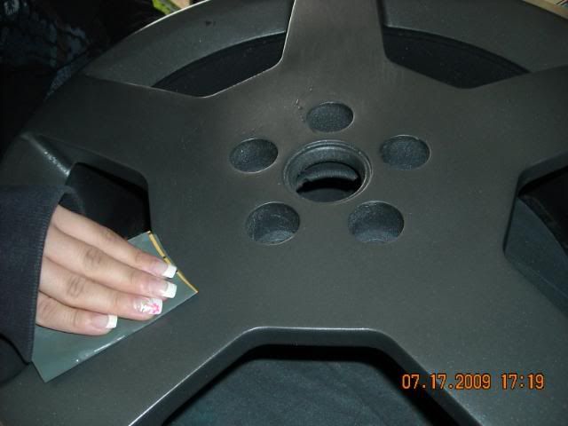

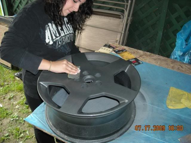

Now begin by roughing up the Current Surface of your wheel with the 180 Grit
Get down to as smooth as you can, NOTE: any kind of change in surface you can feel with ur finger will show up big time when u paint it!...

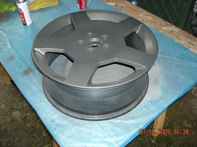

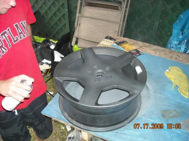

Now take go ahead and primer the wheel...
I did 2 or 3 Coats of primer, lightly sanding the primer inbetween coats!...

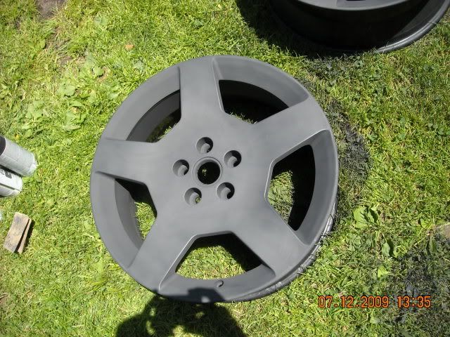

Okay, now after primer has dried, go ahead and rough the surface up a little bit and begin with your first coat of paint! I did TWO coats of this paint...

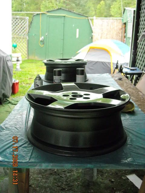

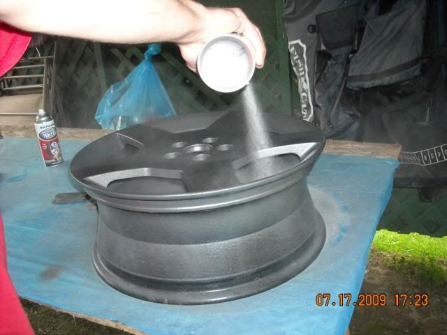

After paint has dried, Now move to your clear coat... begin by wet sanding the surface of your newly painted wheel... Start by clear coating the insides first, then clear the face to insure a smooth finish on the face of the wheel..
This is me clear coating the insides First....
I put 2 or 3 Coats of clear coat on Wetsanding inbetween every coat...

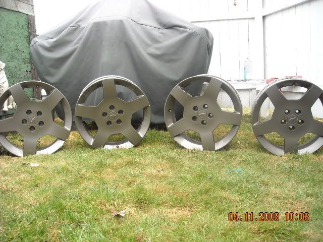

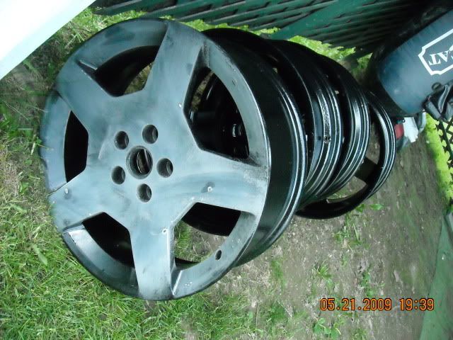

This is the B4 and After ... Note: reason why i painted is becuz stock rims were chipping badly..
Before.
After

Pretty cool. Just putting my 2 pennies in though.. before we use HIGH BUILD primer, we sand it with 320 grit. You'd probably have to put a loot of spray bomb primer on there to hide the 180 grit scratches so if you use that, be careful!
