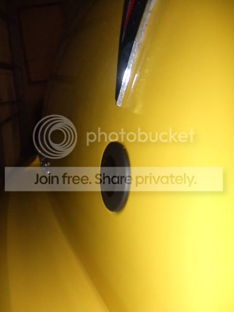

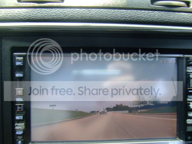

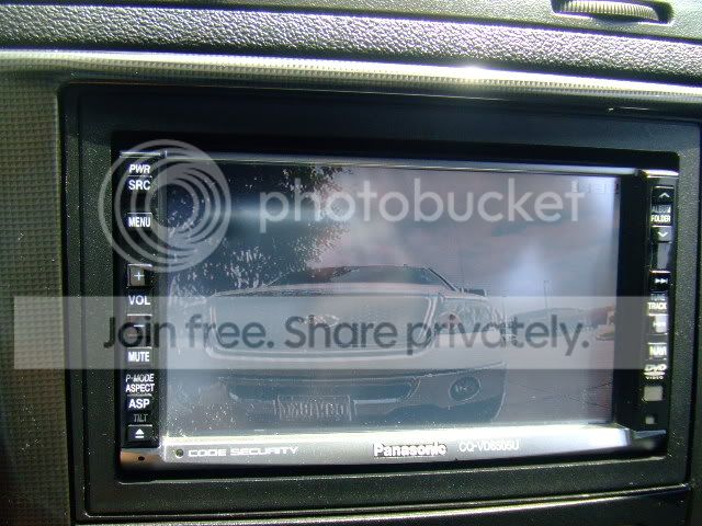

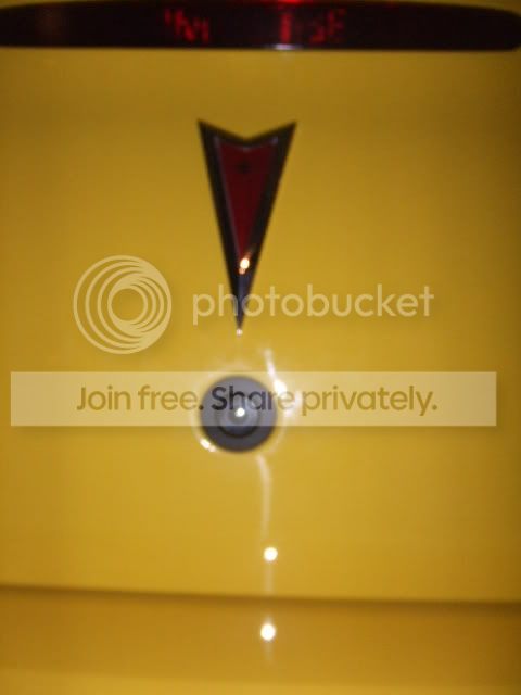

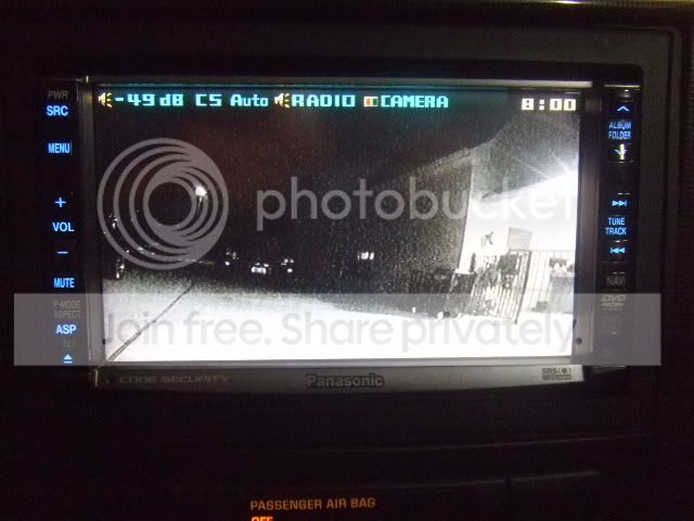

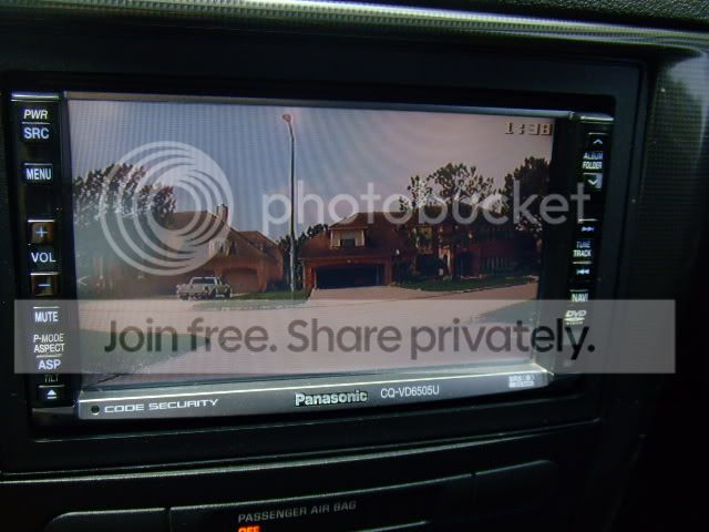

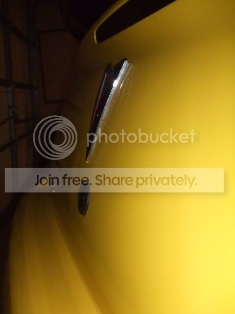

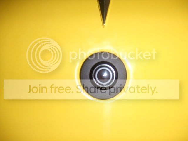

I put a backup camera in place of my key hole on the trunk( now i know some of you are thinking "hey what happens if your solenoid goes bad?" well easy i re-routed one of the seat pulls to the little baby seat latch opening on the rear deck, so when that day comes i can pop the little door and pull the release!), its pluged into my Panasonic head unit, it has night vision, so the grains in the headunit is due to its auto nightvision.
day pics
