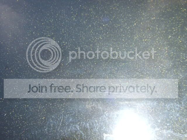

Here is a before and after of my spoiler (you really see a difference on black Paint!)
see all that nasty pollen and crap dots before the clay
Heres after!
