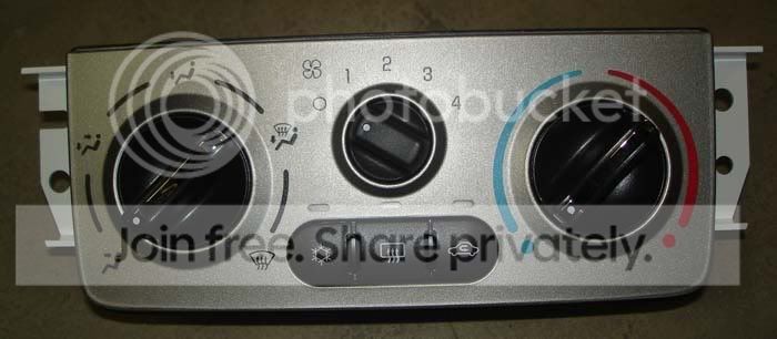

So I have this problem with my a/c...I like it but Im sure its not a good thing. The a/c works fine. But when the a/c isnt turned on and the car is moving it blows out air. You can feel it when you put your hand up to the vents and the temperature in the car. The type of air(hot or cold) depends on where the temp knob is(if its on hot, blows hot air just like normal.) i actually like it but I know its not normal sooo what do yall think is wrong with it?

What do you mean its normal at speed? High speeds?? Wheres the recirculaton button? I forgot I have a 2006 Lt.
When you're moving and the fan is off, you will still get some air coming through the vents due to the location of the air intake for the cabin being at the base of the windshield. So there is a high pressure area right there while moving.
The re-circulation button is the right one in the bottom row here.

Oh ok thank you.
