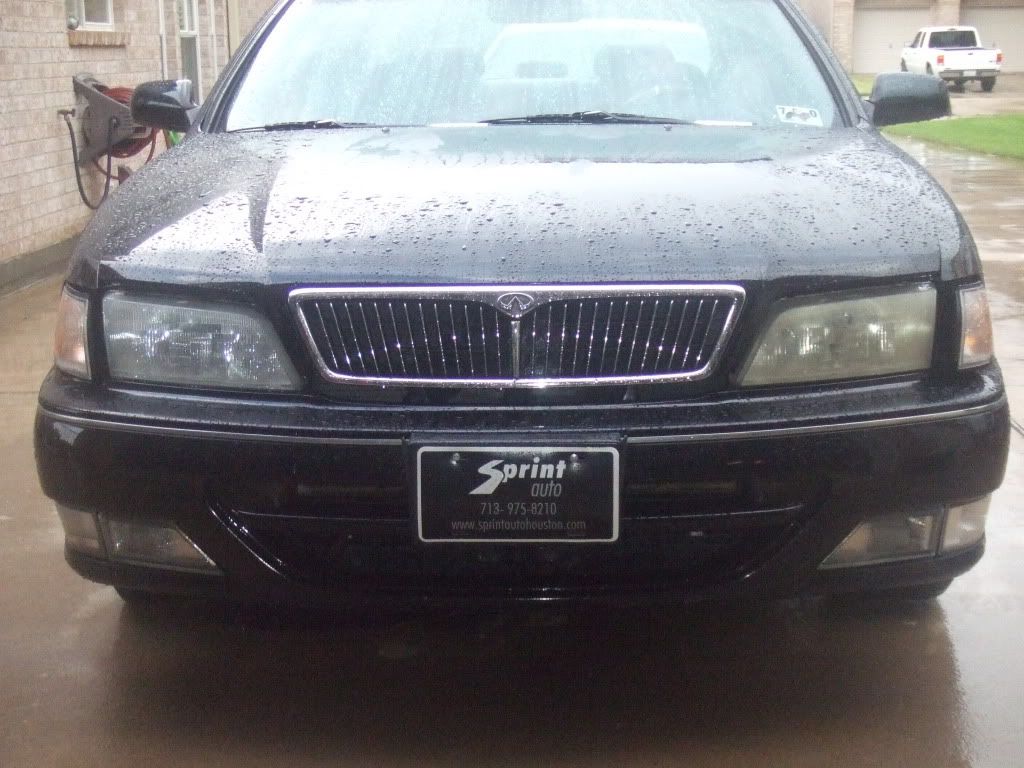

Some of you may know i bought a 2nd car couple months back, 96 infiniti I30, and im in the process of rebuilding it from the ground up(mainly for fun/learning experience), here's some pics of whats been done so far, all mechanical im not too worried about the cosmetics, it will eventually get some paint/body work.

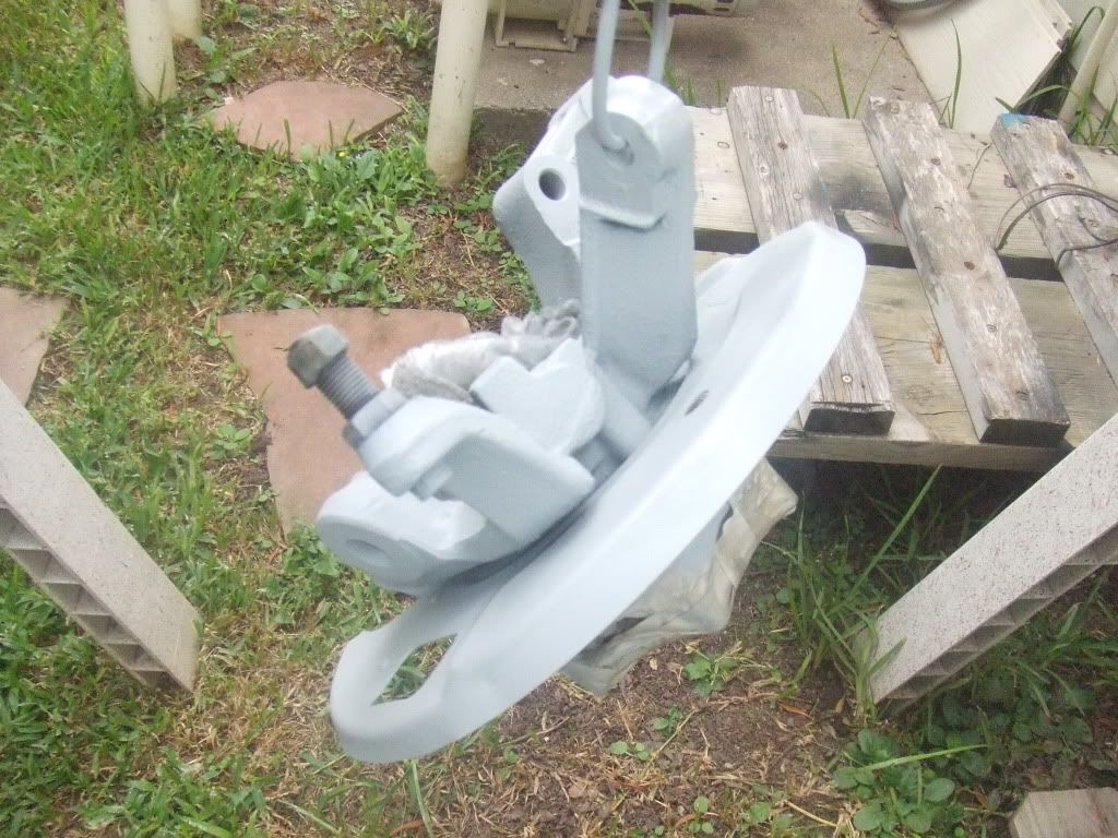

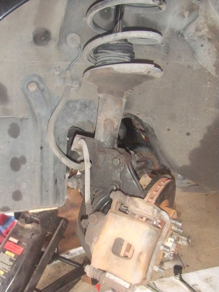

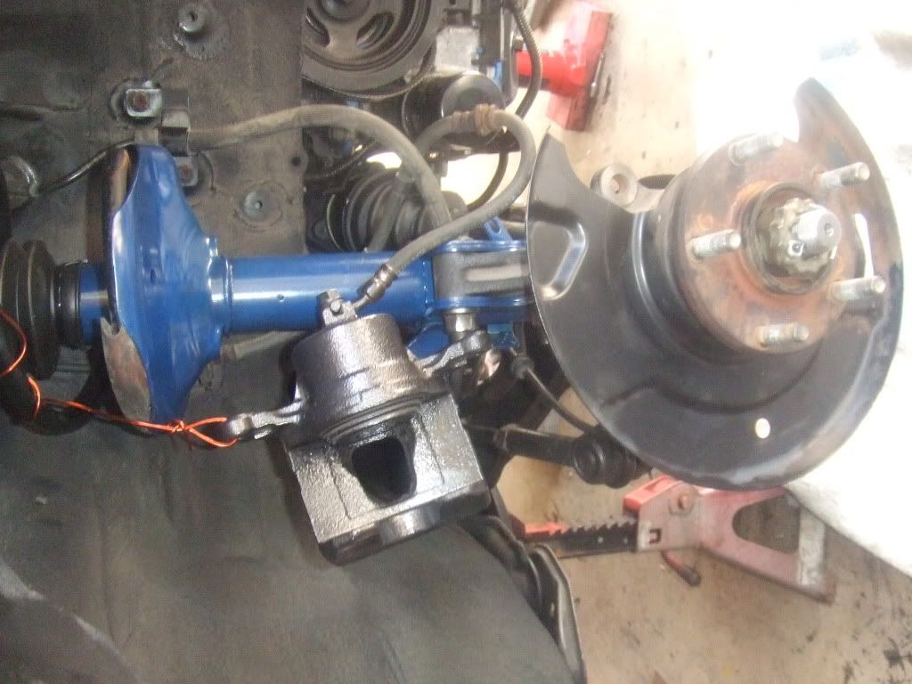

the suspension just the front so far...
old
new

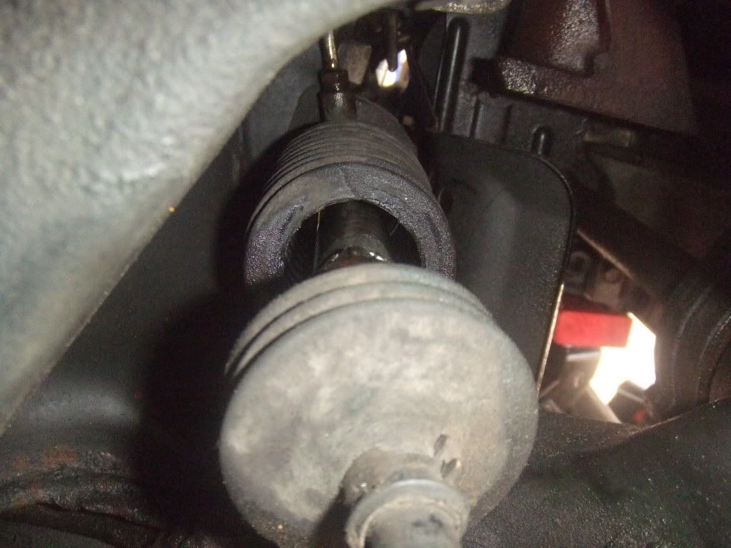

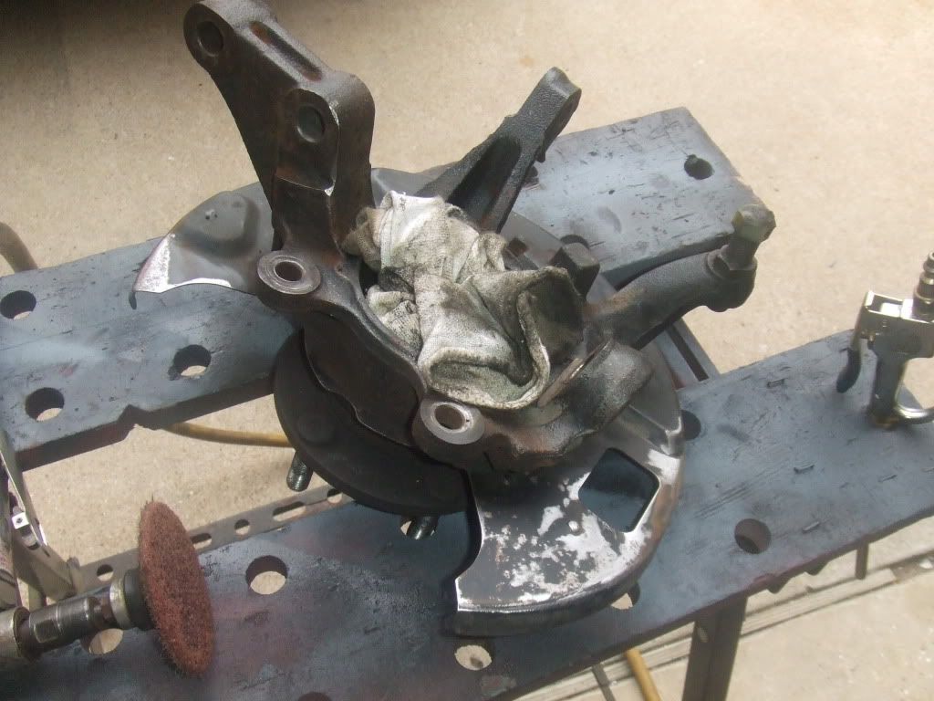

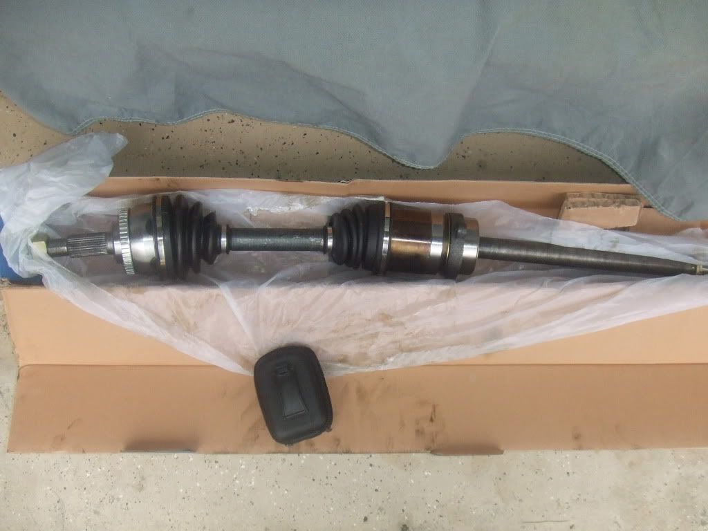

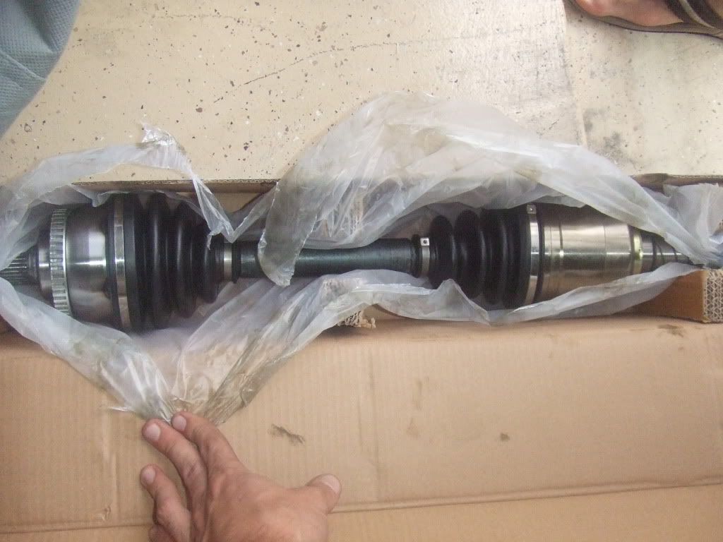

replaced all the boots
the old stuff..
new drive shafts(installed)

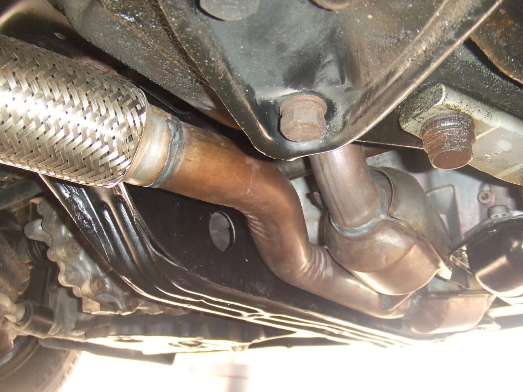

replaced 1st half of the exhaust

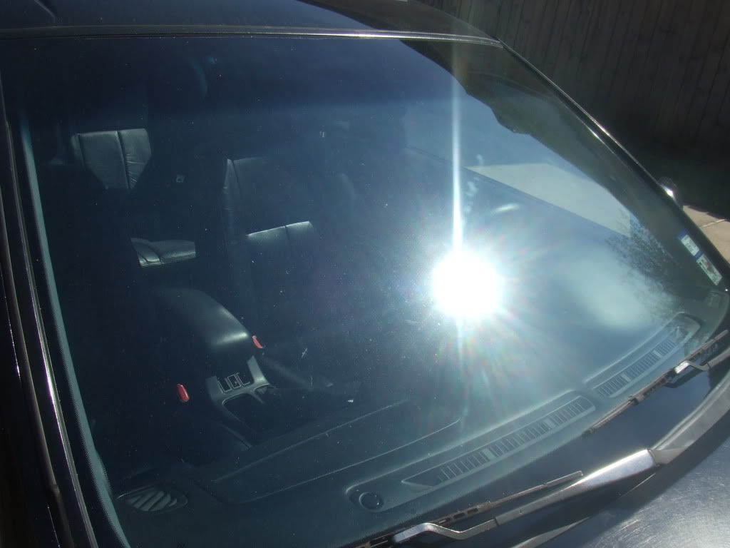

new windshield
old
new

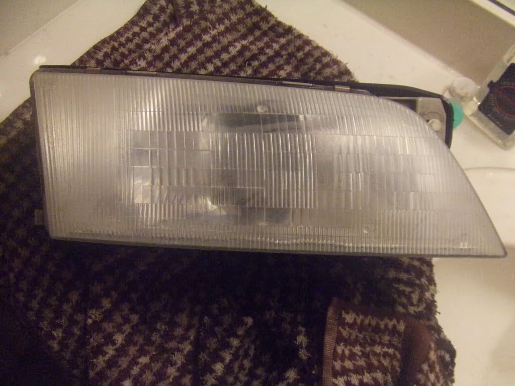

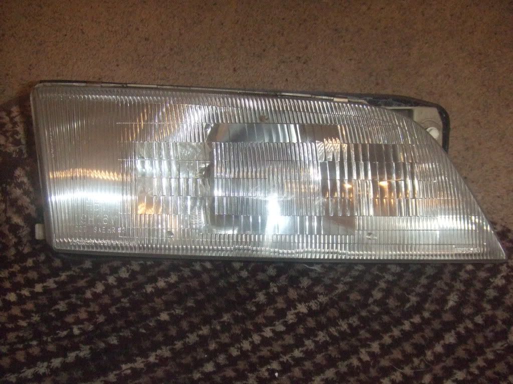

headlights bugged the piss out of me...
left/refinished vs. right(clouded)

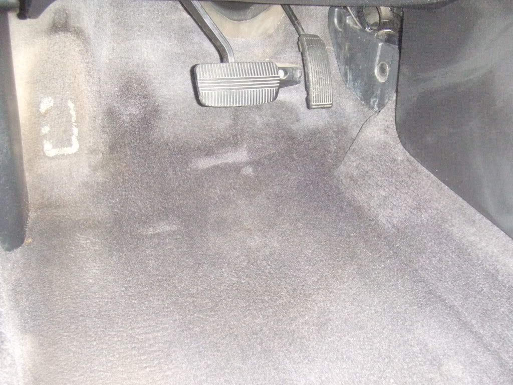

as with the carpet stains(used turtle wax's oxy carpet cleaner A+ stuff
before
after

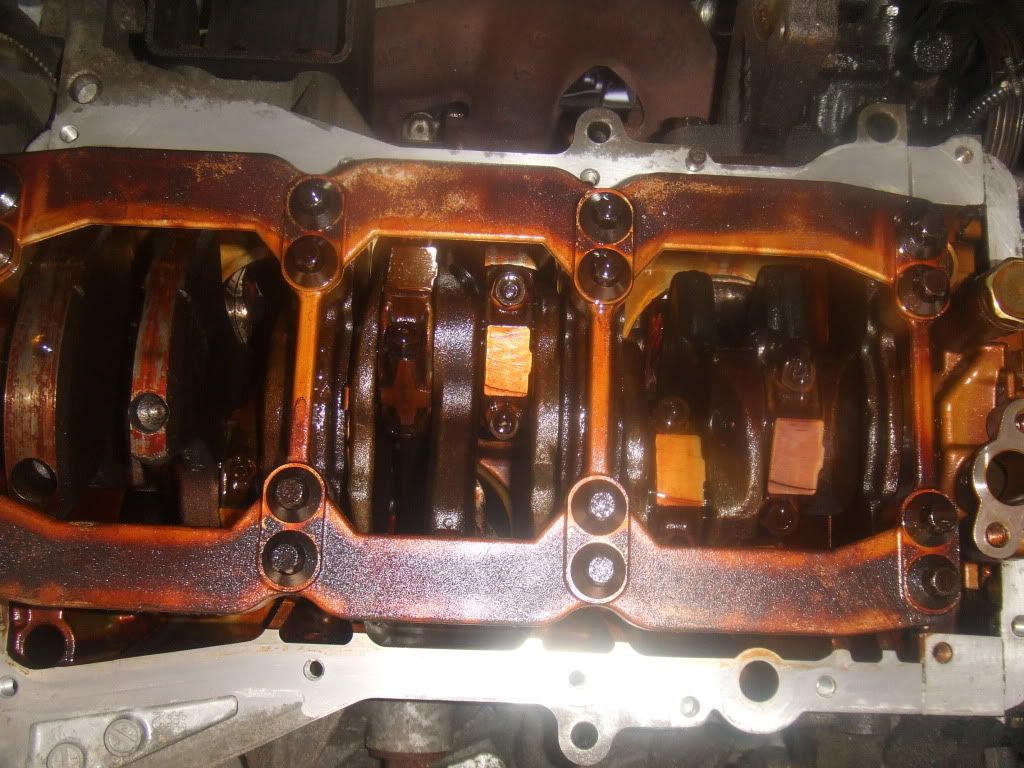

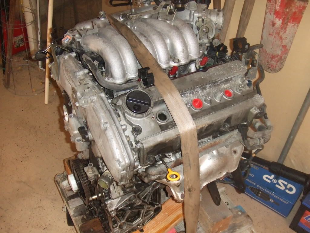

then the oil leak...replaced the oil pan gasket and the upper pan gasket....
replaced both seal points 7 times so far, still the bastard is leaking

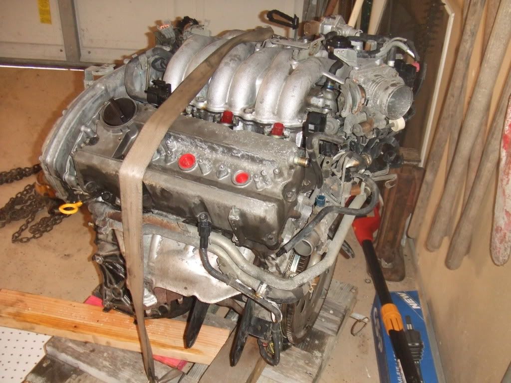

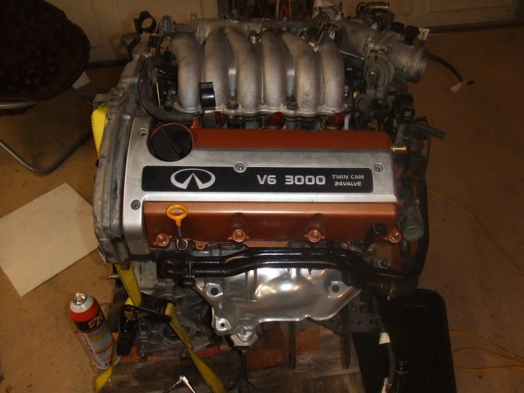

our guess is the timing chain cover...sooo **** it, I bought a donor parts engine...im pulling the old one this weekend..going to check its compression of both engines and then decide which one to use for parts...got it in this morning

update 11/30 new engine is in.
Engine pull went smoother then planed...all references said it cannot be pulled from the top....well i pulled it from the top :cool:
took 7hours-lunch & beer break :lol:
up up and...
away!
